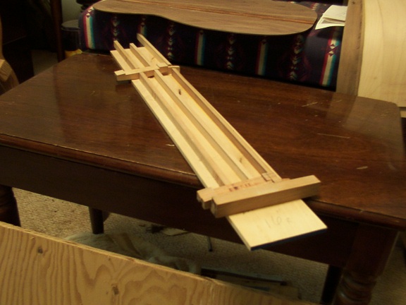

Todd, Thanks for the extra info. Oddly enough, I made a sled for compound radii using the same setup, only the fretboard is the part that does the moving, and I can feed it through my thickness sander. Maybe that`s another way to get around the blow out and problems that come with the inlays.

Here`s a pic of the sled I was referring to. Works well. Haven`t tried it on a board with inlay in it yet. I cut the fret slots first, and radius before the taper is cut.

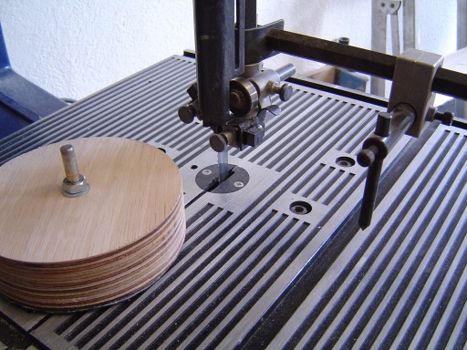

Bruce, my small 12" bandsaw has an attachment especially for circle cutting. It is dedicated to this bandsaw but something similar could be made for any saw very simply. I mostly use it for making the Drill press sanding discs, as in the picture.
PostPosted: Fri Mar 31, 2006 3:35 am
Thanks Colin for that ingenious idea, there's probably a way to achieve the same results with a home made jig set up on the bandsaw table ?? I'll be looking into that!

Don, that`s where the basis for my jig comes in. I the workpiece itself is pivoted, it can be adjusted with each pass through the tickness sander. The point of contact is always in the center of, and the highest place on the jig. I`m sure Todd`s setup could be adapted to do the same thing.
